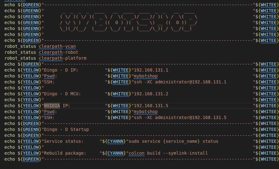

Message-of-the-Day (MOTD)
To configure a custom MOTD:
sudo chmod -x /etc/update-motd.d/*
sudo nano /etc/update-motd.d/45-mbs-motd
sudo chmod +x /etc/update-motd.d/45-mbs-motd
Example MOTD script:
#!/bin/sh
robot_status clearpath-vcan
robot_status clearpath-robot
robot_status clearpath-platform
echo "-------------------------------------------------------------------------------"
echo "Dingo - D IP:          192.168.131.1"
echo "Password:              mybotshop"
echo "SSH:                   ssh -XC administrator@192.168.131.1"
echo
echo "Dingo - D MCU:         192.168.131.2"
echo
echo "NVIDIA IP:             192.168.131.5"
echo "SSH:                   ssh -XC administrator@192.168.131.5"
echo "Dingo - D Startup"
echo "Service status:        sudo service {service_name} status"
echo "Rebuild package:       colcon build --symlink-install"
